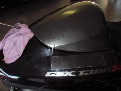

3rd solution from The Shredder.
This one is a preemtive attack against the locked hump bogey.
Next time you have the hump or rear seat off just drill a hole in the side of the duck tail.
You dont even have to worry about the drill running away on you as if your drill bit is sharp just palce against tail & turn it by hand it will cut throught no problems.
( it Cant be seen when seat or hump in place)
Now that the hole is there if this ever happens just lever up the rear & use a bit of coat hanger wire etc & place in the hole to push the lock open as shown below.
