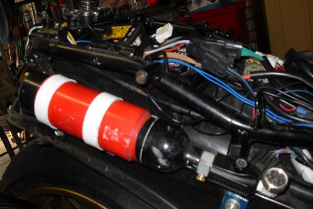

Bottle
[Image: bottleSDC10111.jpg]

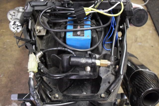

Pump left Bottle on the right & regulater at the rear
[Image: regrearSDC10113.jpg]
Air Shifter Cycletech unit you can buy the kit from Matt (Hes a top Bloke very helpfull) its a bit hard to see
[Image: shifterrear2SDC10118.jpg]
The pump runs to a T at the bottle & it stays open all the time,
then back to the regulator,
then to the air shifter & another line up to the dash with a pressure gauge
I have a switch on the dash to pump up the bottle when it gets low
Hope this helps
