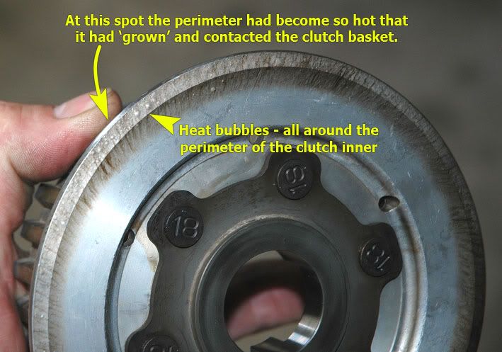

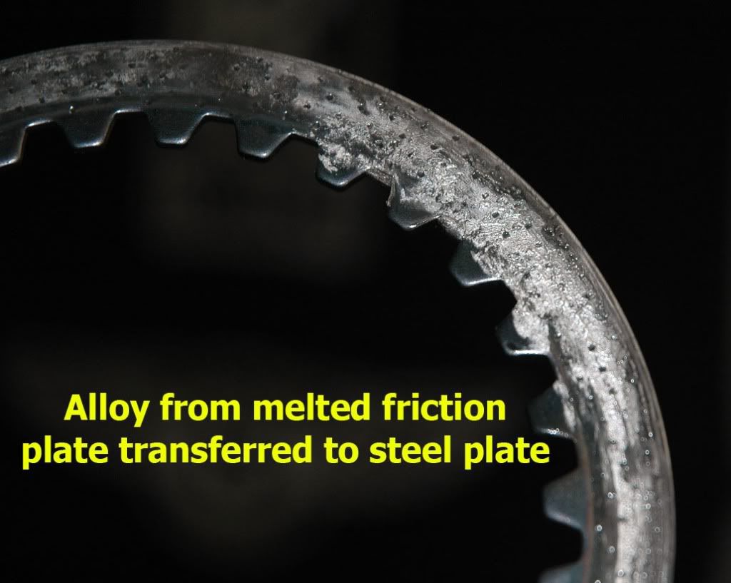

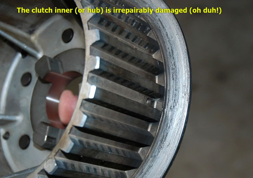

Here's some happy snaps from a slipping Busa clutch I recently overhauled, replacing the BTL with a non-BTL MTC hub.
On dismantling, here's the sight that greeted me...
[Image: Platescopy.jpg]
[Image: AlloyonSteelcopy.jpg]
[Image: Meltedcopy.jpg]
[Image: Clutchhubcopy.jpg]
[Image: meltedperimetercopy.jpg]
There was melted aluminium all through the engine including the oil jets! Luckily for the owner he'd stopped riding when he did. It could have destroyed the engine.
