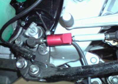

Shifter
Sorry the other was on rear sets I did not think about that so here is another picture of one it did on a OEM set

Which sensor do you have? the one in the picture is the one for the busa. the one in the top came from dynojet a week ago and the other came in 6 mth ago
The model shown is the Linear Sensor which is the Part suggested for the Hayabusa and is superceded by a model that looks similar to the Pressure/Tension Sensor.
If you want to replace the Shift Rod you require either the Shift Rod Tension Sensor (Pull Type) m6/m6 threads 4-101 or the Shift Rod Pressure Sensor (Push Type) m6/m6 threads 4-102 depending on Shift patten both requiring Male/Male Shift Rod B (Black Anodized Aluminum) 32104050.
Not sure why they use the Linear Sensor as the Pressure/Tension Sensor works quite alright.

I used the Linear Sensor Because that is what Dynojet sent for the Hayabusa!
abusa Wrote:The model shown is the Linear Sensor which is the Part suggested for the Hayabusa and is superceded by a model that looks similar to the Pressure/Tension Sensor.

As it works out i went back to the shop today and informed them of my situation. I spoke withthe head mechanic there, and he agreed with me that a linear unit is not the best option for the hayabusa and was goign to be talking to a rep from dynoject on saturaday afternoon. I assume they will get the correct unit organised for me.
I was of the assumption that the unit for the busa would replace the factory link rod, and not have me to goof around with drilling holes and so on in my chasis. Thats what im not thrilled about.
The one that is on that link is the one that has been sent to me.
That's the 4-104 linear push type, and its to long to mounted up to the gear position sensor thingy link others have shown.
