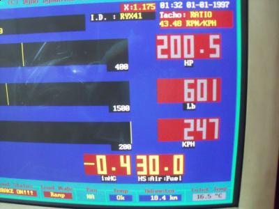

WHO has ACTUALLY got 200HP at the back wheel without turbo charging, what did you have to do to get it and to be honest, was it WORTH IT in the context of money spent vs everyday riding.
Reliabilty (probably not suspect) and rideabilty wise, are there any minuses?
Perhaps, someone might even wish they didn't do it(!) Lets hear your stories!
Simplest i have done is a dry nos on a gen 1 and flashed it to suit, ecu turns on the nos within a window of rpm and tps , only hardware you need is nos bottle& bottle heater, line ,solenoid,distribution head with 4x .018 jets and the adapting boostbysmith loom , stepped from 167hp to 207 with very little time effort or money.
Same same as Greg ................... with Gen 11 a good set up and correct fueling will get you within 2 Hp of it.
Well according to 10 tenths in Sydney, my '06 achieved 209ph with a new set of pistons, flashing and a different inlet cam..

So back to the question ............. I've not seen 200Hp on anything that hasn't had internal engine mods N2o or Turbo and agree with Greg in that gas has to be the best bang for buck by far.

I dont see why not , there been a few gen 2 with full system's ( not slip on mufflers) & either a pC or ecu reflash tune dyno within a couple of hp from yours on different dyno's.
1 fist, 2 figers & a thumb
Good air on a good day .............. don't see why not Pi_thumbsup
After all 2 Hp is barely a line thickness.
If you have a gen2 you already have a head start.
on average there about 20hp more than the gen 1
So a good full exhaust system & tune will just about get you there.
Theres a few of us in brissy with anywhere between 193 & 196 hp once tuned. ( different dynos as well)
If you can tell the difference in a couple of hp when riding your doing well.
Check out the drag guys at the moment running gen2's there times & mph gives an idea that the hp is close & most havent opened the motors

[Image: b76e01eb-552d-45d5-97df-028004b674c3_zps59f1c171.jpg]
