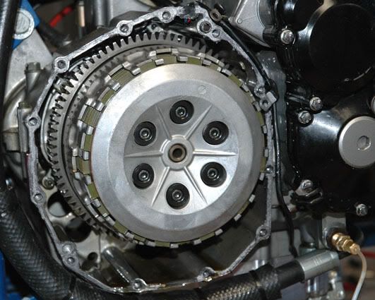

Be Brave! Just take your clutch cover off and then the six socket head screws that hold your clutch springs in place (the six dark ones below). The pressure plate will then come off and your clutch plates can be pulled out.
You can then visually inspect and measure them to see if they're stuffed, or whether a further tear down is required.
[Image: clutchcomplete.jpg]
Camel
Make sure you put loktite back on the screws when rebuilding the clutch.
