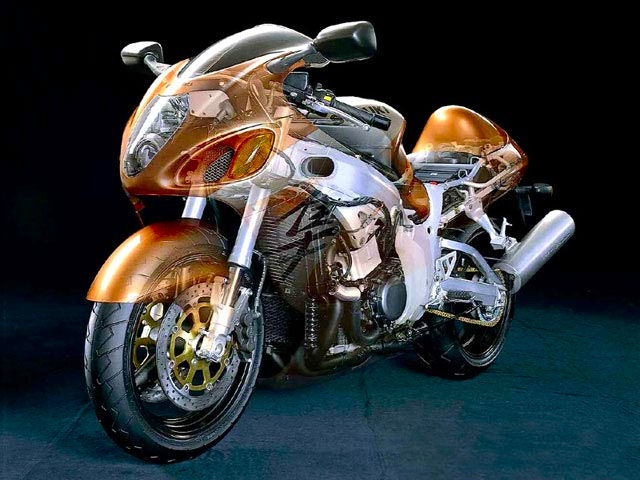

Specifications for Suzuki GSX 1300R Hayabusa
  • Engine Configuration: Inline Four, 4-stroke, DOHC Engine Displacement: 1298 cc
  • Engine Cooling System: Liquid
  • Compression Ratio: 11.0:1
  • Combustion Chamber Design:  Twin-swirl
  • Valves Per Cylinder: 4
  • Intake Valves Per Cylinder:  2
  • Exhaust Valves Per Cylinder: 2
  • Bore x Stroke: 81.0 x 63.0 mm [forged ART pistons]
  • Claimed Peak Horsepower:  175 ps/172.6 bhp @ 9800rpm
  • Claimed Peak Torque:  102.0 lbs-ft. @ 7000 rpm
  • Measured Peak Horsepower @ rpm: N.A.
  • Measured Peak Torque @ rpm:  N.A.
  • Claimed Power To Weight Ratio: 3.16 pounds/horsepower
  • Engine Redline: 10,900 rpm
  • Valve Angle (Included):  28 degrees (14 degrees Intake, 14 degrees Exhaust)
  • Combustion Chamber Volume: 18.8 cc
  • Valve Train Type:  DOHC, Link-plate Chain
    Drive, Bucket Followers,
    Shim-under-bucket Lash
  • Valve Timing Measuring Point:  0.3 mm
  • Fuel Delivery System:  Electronic Fuel Injection
  • Throttle Body Venturi Size:  46 mm
  • Air Filter Type:  Non-woven Fabric
  • Exhaust System Type: 4-2-1-2
  • Ignition System:  Digital Electronic
  • Lubrication System: Wet Sump
  • Oil Capacity:  3.7 quarts (3.5 liters)
  • Fuel Capacity:  5.8 gallons (22.0 liters)
  • Transmission Type: 6-speed, Constant Mesh
  • Clutch Type: Multi-plate, Wet Clutch Actuation System: Hydraulic
    Clutch Spring Type: Coil
    Number Of Clutch Springs: 6
    Number of Clutch Plates: 19
    Drive Plates: 10
    Driven Plates:  9
  • Primary Drive: Gear
  • Primary Drive Gear Teeth (Ratio): 52/83 (1.596:1)
  • Final Drive Sprocket Teeth (Ratio): 17/40 (2.352:1)
  • Transmission Gear Teeth (Ratios):
    6th                  24/23 (1.043:1)
    5th                  25/22 (1.136:1)
    4th                  27/21 (1.285:1)
    3rd                  29/19 (1.526:1)
    2nd                 31/16 (1.937:1)
    1st                   34/13 (2.615:1)
  • Transmission Overall Ratios:
    6th                   3.918:1
    5th                   4.267:1
    4th                   4.828:1
    3rd                   5.732:1
    2nd                  7.276:1
    1st                    9.822:1
  • Theoretical Speed In Gears At Redline:
    6th 199 mph / 320 kmh
    5th 183 mph / 295 kmh
    4th 162 mph / 260 kmh
    3rd 137 mph / 220 kmh
    2nd 108 mph / 175 kmh
    1st 80 mph / 130 kmh
  • Engine Speed At 60 mph:  3300 rpm
  • Frame Design (Material): Twin-spar
    (Aluminum Alloy)
  • Rake/Trail: 24.2 degrees/3.8 inches (97mm)
  • Wheelbase: 58.5 inches (1485 mm)
  • Seat Height: 31.7 inches (805 mm)
  • Foot peg Height:  14.6 inches (370 mm)
  • Handlebar Height: 34.6 inches (880 mm)
  • Steering Stem to Seat Center: 34.4 inches (875 mm)
  • Front Forks: KYB Inverted, Cartridge
  • Fork Tube Diameter: 43 mm
  • Fork Adjustments: Rebound Damping  14 Positions (clicks)
  • Compression Damping  13 Positions (clicks)
  • Spring Preload 15 mm Range
  • Front Wheel Travel: 4.7 inches (120 mm)
  • Rear Wheel Travel:  5.5 inches (140 mm)
  • Rear Suspension Type: KYB Single Shock, Progressive Linkage
  • Rear Shock Adjustments: Rebound Damping 22 Positions (clicks)
  • Compression Damping 22 Positions (clicks)
    Spring Preload 10 mm Range
  • Front Brakes: 320 mm (12.6-inch) Dual
    Discs, 6-piston Tokico Calipers
  • Rear Brake:240 mm (9.4-inch) Disc,
    Opposed-twin-piston Tokico Caliper
  • Front Wheel:  3.50 x 17-inch Cast
    Aluminum Alloy
  • Rear Wheel: 6.00 x 17-inch Cast
    Aluminum Alloy
  • Front Tire:  120/70ZR-17 Bridgestone Battlax BT56 Radial
  • Rear Tire: 190/50ZR-17 Bridgestone Battlax BT56 Radial – OEM tire specs at 198mm
  • Claimed Dry Weight: 474 pounds (215 kg)
  • Claimed Wet Weight: 546 pounds (248 kg)
  • Weight Distribution (claimed): 51F/49R (percent)
  • GVWR : 948 pounds (430 kg)
  • Overall Length : 84.3 inches (2140 mm)
  • Overall Width: 29.1 inches (740 mm)
  • Overall Height: 45.5 inches (1155 mm)
  • Ground Clearance: 4.7 inches (120 mm)
Key Features
  • Aerodynamic fairing design with low drag coefficient.
  • All fairing components have been designed for reduced drag and turbulence.
  • Compact 4-stroke, four-cylinder liquid-cooled engine with DOHC, 16-valves, Twin Swirl Combustion
  • Chambers, plus gear-driven counter balancer for smooth operation.
  • Electronic fuel injection system, fed by 46mm throttle bodies and ram air intake with large volume airbox.
  • Lightweight shim-under-bucket valve train with narrow 14 degree valve angle for high combustion chamber efficiency.
  • High efficiency liquid cooling system for optimum engine operating temperature- including compact air-cooled oil cooler, plus oil-jet piston cooling.
  • SCEM (Suzuki Composite Electro-chemical Material) plated cylinders minimize cylinder size and improve heat dissipation.
  • 6-speed transmission with high-capacity clutch featuring back-torque limiter system for smooth downshifts and scissors-type primary gear for reduced gear noise.
  • Large volume 4-into-2 exhaust system with stainless steel head pipes and lightweight aluminum silencers.
  • Digital direct-ignition system combines an ignition coil with each spark plug cap for reduced weight and stronger spark.
  • Full instrumentation with ultra-thin step-motor construction. Includes fuel gauge, clock, temperature gauge, LCD odometer and twin trip meters with fuel consumption gauge.
  • Unique, vertically mounted dual headlight provides a bright, wide beam with a 60W projector-type high-beam and a 55W low-beam halogen bulb.
  • Rigid twin-spar aluminum frame minimizes weight while maintaining high torsional strength.
  • Large diameter (43mm) inverted front forks with fully adjustable compression & rebound damping and spring preload, plus steering damper.
  • Proven link-type rear suspension with remote reservoir shock absorber. Rear suspension features fully adjustable rebound damping and compression damping and spring preload
  • Bridge-type swing arm with large diameter swing arm pivot shaft provides high swing arm rigidity.
  • Powerful front disc brakes with large 320mm discs and 6-piston calipers.
  • Rear disc brake with 240mm disc and 2-piston caliper.
  • Radial tires mounted on lightweight 3-spoke aluminum wheels. Wide 190-size rear tire is mounted on 6″ wide rim.
  • Hinged fuel tank simplifies maintenance and provides easy access to the airbox and air filter.
  • Oh yeah…and it’s fast!
